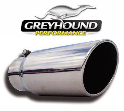

6) 4"in/5"out tip, 12" long, slanted & rolled $37
GP Stainless Steel Diesel Exhaust Tip 4" to 5" Bolt on 15 Degree Angle Cut 12" L | eBay
