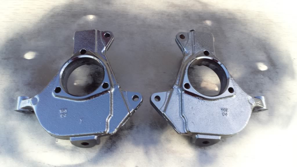

Didn't do threads, taper, or pivot point. Taper is tight without powder, and not visible when installed. Only reason I removed it all was I did new inners as well.
I did not think a home over got hot enough to bake the powder. Pretty slick. Not sure how I would feel cooking dinner in it the following night HAHA
Pretty sure from the look of the floor, it's out in a shop or garage and they don't cook any food in it.
Did it fix the issues you were having Austin?
I'm not even done disassembling. Everything's being cleaned, probably strip and paint frame while its down this far.
Definitely shop oven, headlights, powder etc.

Gonna swap spindles wednesday to hopefully get rid of this dreaded bumpsteer
All done
I know you're far from reassembly, but the heim will end up on the bottom portion of the stud for most trucks.
Yeah, I didn't wanna thread the lock nut down yet or have it flopping around. Probably going to have to play with the height/end links to get them to play nice haha
