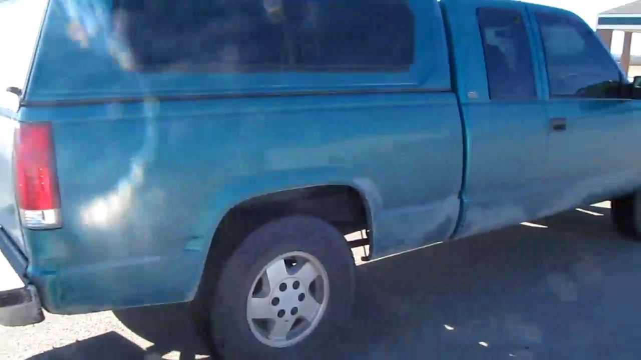

So i have been putting miles on the truck getting it broke in and ready for the long trip ahead of me. Decided to snap a few pics today (truck is really dirty due to the quick moving snow we got last night)
Really not liking it being so dirty.........gotta wash it tomorrow

Have always loved that color.

When i first got the truck i wasn't a diehard fan of the color but it grew on me bc of how unique it is. Ive seen a few trucks similar to mine only one that was identical. Thanks for the kind words, shocking how the saying "the good die young" always is true.
